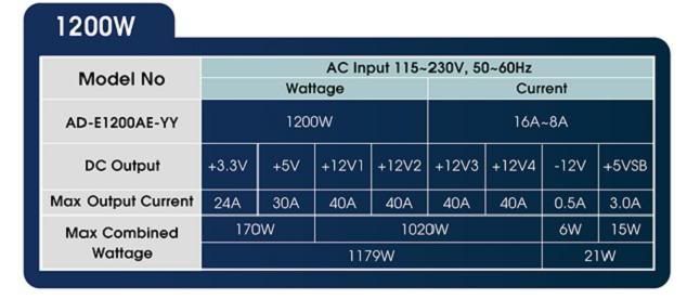

Performance (40% of the final score) – the Ultra X4 1200 watt model started off with a bang and ended with a resounding thud. Yes, it did the whole one thousand two hundred watts of rated power. But it was hardly without issue. First, we saw efficiency numbers so embarrassing they left me wondering how this unit could have ever passed 80 Plus standard, let alone Bronze. Then, due to a fair sized gap between the 12V maximum capacity and the total rated capacity, we saw some not so good voltage stability from the 3.3V and 5V rails due to the need to max them out to get up to full power. Last but not least, we have a unit that was only too happy to exceed ripple specs at 12V for several seconds before the overtemp protection was able to kick in and shut the unit down. There are a few good points about this unit, like the overshoot transient protection, the ripple suppression, and the 12V regulation, but for the most part it's all overwhelmed by sheer blandness. This unit gets a 5 for being so… well… so-so when everything is taken into consideration.
Functionality (20% of the final score) – if the performance score of this unit is worthy of a big point smackdown, the functionality score is going to be the exact opposite. Why? Well, not too many companies do modular like Ultra, who holds the patent on it. Every last cable is neatly and obsessively sleeved, each with its own little velcro cable tie. If you need to pull the main ATX cable off, you can. There's no chance of mixing up the connectors on the back of the unit. There are tons of connectors for every possible combination of parts this unit is able to run, and yes, Virginia, you can run three way SLI on this unit without worry because you'll not be able to hit 1200W with a modern 12V based rig on this unit. 10.
Value (30% of the final score) – Provantage is currently offering these for $256.56. Yes, folks, for the low low price of two hundred, fifty-six dollars and fifty-six cents, you too can own a 1200W power supply with 1020W of useable 12V capacity for your very own. Just… don't pay any attention to that BFG EX-1200 over there, which uses a superior Andyson built platform to this one. No, it's not forty two bucks cheaper, you're seeing things. No, the 80 Plus Gold rated OCZ Z series unit over there isn't seven smackers cheaper either. 5.
Aesthetics (10% of the final score) – I have to admit, the looks of this unit are the best thing it has going for it. I have to do a 10 here, I just have to.
Performance
Functionality
Value
Aesthetics
Total Score
6.5
Secondary side capacitors are all Teapo. Primary capacitor is Panasonic.
Main PWM controller is a CM6800G. Topology is a double forward converter.
This is the secondary sink, complete with two thermistors – one for fan control, the other for overtemp protection. The 12V output is done with four ESAE83-004 Schottkys. These are 60A rated parts. The 5V and 3.3V sections are identical, each gets two 30L30CT's. Finally, there a STPS20L60C3 for the 5VSB.

Yo hable con Oklahoma wolf de jonny guru.com , de todo.. Andyson , Ultra X4 , le linkie la pagina de Powercooler etc,
Con respecto a estas andyson… La arquitectura es para una fuente de 800w… Son realmente malas, y no lo digo yo solo ee.. http://www.jonnyguru.com/forums/showthread.php?t=6231

Fallo las 3 ultimas pruebas de que me estas hablando???? PUM FAIL … No es una cosa para opinar.. Te lo dice la maquina jajajajajja.
No pero seguro que:
1)El loader y el ociloscopio mienten (?)
2) Al reviewer le pagaron para hablar mal de la fuente.
3) El reviewer no entiende nada de fuentes (?)
Test
5 19A 19A 85A 1193W/
1560W 76.4% 48°C/
85°C
FAIL FAIL FAIL
Test
CL1 19A 19A 4A FAIL N/A FAIL
FAIL FAIL FAIL
Test
CL2 1A 1A 85A FAIL N/A FAIL
FAIL FAIL FAIL
FAIL

Darlington no te hagas el sota, tengo entendido que algo de fuentes entendes..,.
Vos sabes que con la misma arquitectura que la Ultra 850w con capacitores y rectificadores upgraedeados no alcanza..
Mira los comentarios:.
"I wonder if Andyson is proud of their work on this unit? "
"Swing and a miss "
" Only the two boost diodes in parallel can make me feel like it's a 1KW+ unit. Andyson pushed the "PSH" this far and that's about all it can do. "
